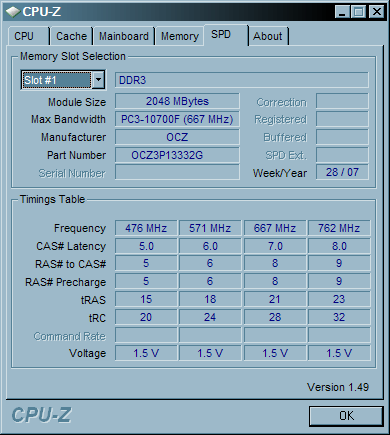

Are all of your memory modules identical (same OCZ3P13332G revision with identical SPD tables)?
Please check the SPD Profiles of each stick with CPU-Z.  Look for internal model numbers/serial number & production weeks/dates as well.  Post a screenshot of the CPU-Z SPD view(s) here.

Yes, they are all the same model, have the same SPD tables. Even the production week is the same on all modules.

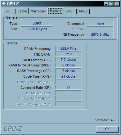

I've set the memory timings myself as with the boards default settings it sets the timings to 7-7-7-21 1T, which is not stable at the default voltage of 1.50v. I tried higher values as well, up to 8 9 9 23 2T, but those seem to have no effect on the booting issues and stability with 6 sticks active. From 1.55 onwards I can use the 7-7-7-21 timing, but then windows doesn't boot anymore, even when I don't use auto setting for voltage, but set it to 1.50v manually.
Also, this memory is stable at 1.55, 1.60 etc. so why can't I boot then with those settings? Why does it boot on 1.50 auto setting, but not 1.50 manual setting?? If this memory is rated at 1.8v, then why does SPD give values of 1.5v? And even with that table, the board doesn't seem to use them..
