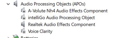

I wanted to add one more thing, since I was having a few more BSOD with the latest version of the NVIDIA driver.
If you disable the following Audio Processing Objects (APOs) all the BSOD's disapear, and the latest drivers work great:
So I only kept the Realtek audio effects active. This fully fixed all the issues.
Maybe you still needed this, have a nice day!
