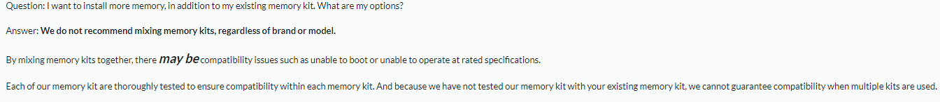

This is not an MSI problem, you are not following the memory manufacturer's recommendation. It's plain and simple; YOU CANNOT MIX TWO MEMORY KITS TOGETHER AND EXPECT THEM TO WORK AT RATED SPEED.
They are sold as kits for one reason and there's a reason why I had to pay a fortune for a 64GB memory kit @ 6400 MHZ instead of buying 2 kits of 32GB @ 7200 MHZ
You can blame MSI or Intel but that won't change anything; it's been the case since ever with any MEMORY KIT.
